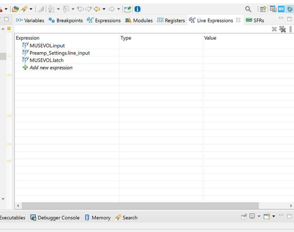

You can use 3 variants, Variable view shows local variables in breakpoint area automaticaly,
Watch 1 and 2 shows your selected variables, and Live variables shows selected on run state too.

Watch 1 2 i miss from other system but in IDE switched to debug perspective you see all

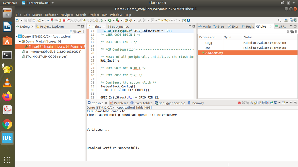

But when I use that I could not see the value of variables. It is showing as below
You can live only global static variables, for local you need break your code on place where exists...
