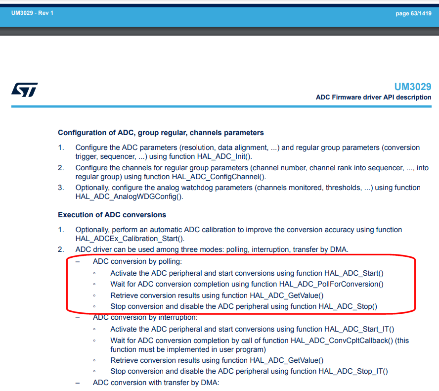

Andrew Neil
@Gaston wrote:
In this application I don't want to use DMA or Interrupts
So "Polling", then:
And how do you select the channel you want to convert? For example:
  • Select ADC channel 0
  • Start ADC conversion
  • Wait for EOC
  • Read ADC value
  • Stop ADC
  • Select ADC channel 4
  • Wait for EOC
  • Read ADC value
  • Stop ADC
You can see an example project to convert a channel in polling mode here:
STM32CubeF4/Projects/STM32F413ZH-Nucleo/Examples/ADC/ADC_RegularConversion_Polling/Src/main.c at d7cb2bb74395b7f27e137da8adb5ad25f0aa0e78 · STMicroelectronics/STM32CubeF4 (github.com)
just - how i would do it (kiss - Keep it Short and Simple :) )
setup with Cube the ADCx (adc1 if you want) regular conversion , set ch0 and sample time (7.5) , one conversion only.
(short "sequence" ) - gen. code , look at the program:
HAL_ADC_Start(&hadc1, ...)  will convert this channel, ch0 , thats what you want.
But now you want ch4 : so just look, how Cube made the adc_init :
 /** Configure Regular Channel
  sConfig.Channel = ADC_CHANNEL_0;
  sConfig.Rank = ADC_REGULAR_RANK_1;
  sConfig.SingleDiff = ADC_SINGLE_ENDED;
  sConfig.SamplingTime = ADC_SAMPLETIME_7CYCLES_5;
  sConfig.OffsetNumber = ADC_OFFSET_NONE;
  sConfig.Offset = 0;
  if (HAL_ADC_ConfigChannel(&hadc1, &sConfig) != HAL_OK)
    Error_Handler();
For ch4 : so just look, how Cube made the adc_init, copy it, and change it to ch4 .
 ADC_ChannelConfTypeDef sConfig = {0};
  sConfig.Channel = ADC_CHANNEL_4;
  sConfig.Offset = 0;
    Error_Handler();
call/run this then...ch4 is now the"sequence" .
HAL_ADC_Start(&hadc1, ...)  will convert this channel, ch4 , thats what you want now.
And so on...
