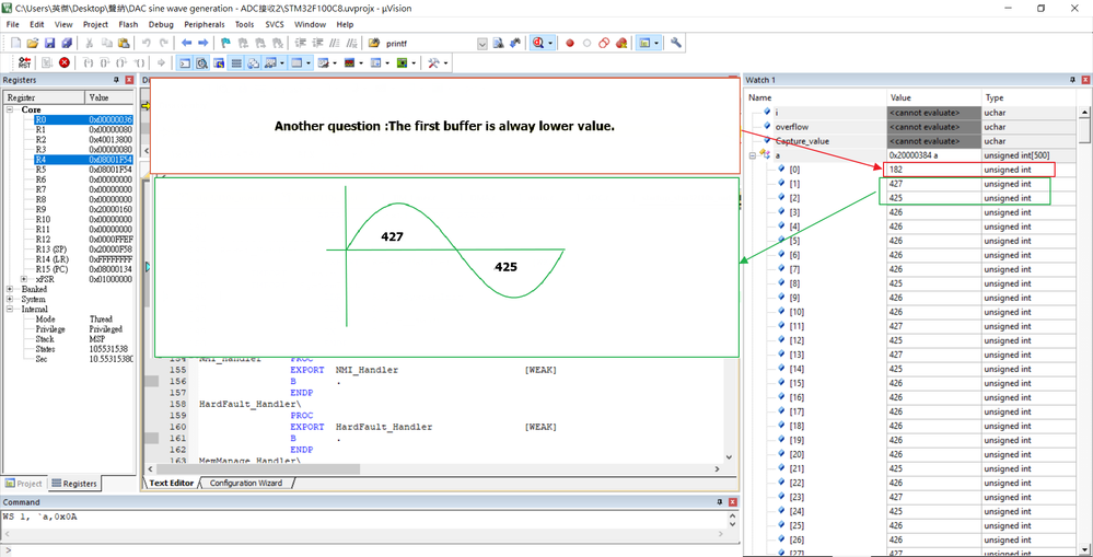

How to use STM32F100 to measure a sinwave's frequency by input cature mode of TIM3 ?
  • February 23, 2019
  • 3 replies
  • 1756 views
I would like to measure sinewaves of three frequency, 39Khz�?40Khz and 41Khz.
Voltage level (0V​-3V)
The 39khz period is 25.64us.
The 40khz period is 25us.
The 41khz period is 24.39us.
I use timer to count.
TIM_CLK= 24M 1s =24000000 clk
counting times = 1s/2400​0000 clk = 0.042 us/clk , prescaler =1
The timer count once per 0.042 second.
Calculation count value: (I should get the following values )
39kHz: 25.64us/0.042us = 610
​40kHz: 25us /0.042us = 595
​41kHz: 24.39us/0.042us = 580
Experimentalphoto:
1: at intput 39kHz sinewave
count value=427+425 =852 >> 610
f=1/T=1/(852*0.042us)=27.9Khz it is wrong.

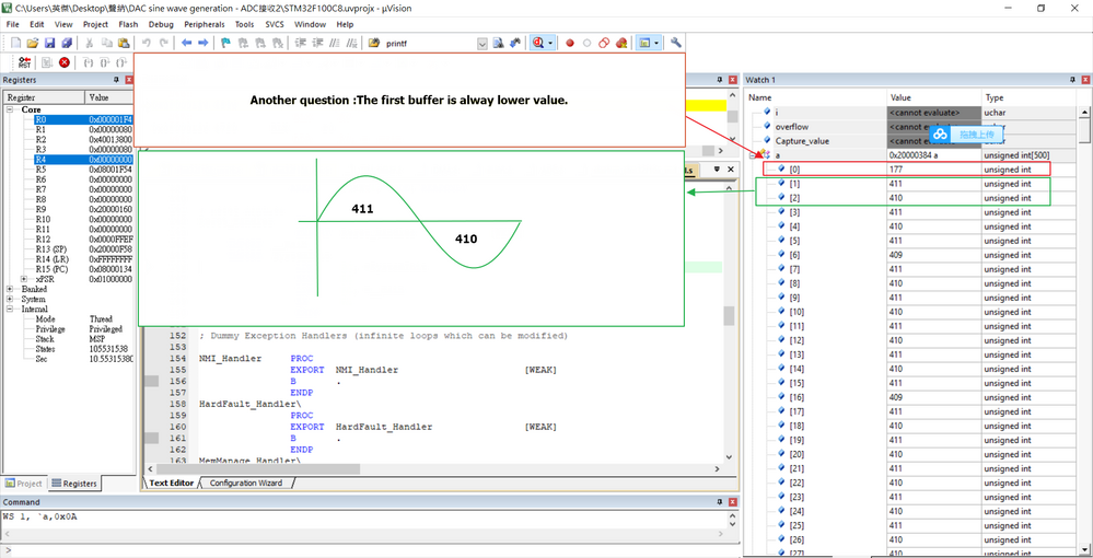

2:at intput 40KHz sinewave
count value =411+410=821>> 595
f=1/T=1/(821*0.042us)=29Khz it is wrong.

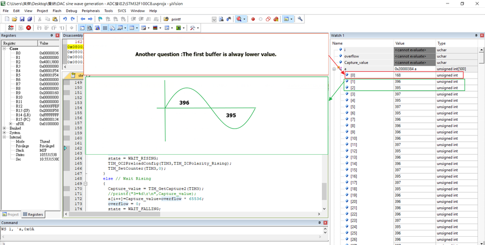

3:at intput 41K sinewave
​count value =396+395=791>> 580
f=1/T=1/(791*0.042us)=30.1Khz it is wrong.
I study the datasheet and try it ,however I still can't get to correct frequency.

Timer channels are digital with trigger voltage defined in datasheet.
If the input is not digital, jitter may occur in the triggering time.
One approach could be to prescale (average) the input in the timer (use channel 1 or 2 as they have more options around for this), so instead of measuring one period, you would measuer 8 periods for example.
I haven't used the internal analog comparator which maybe can convert analog to digital and feed the timer. Again, without hysteresis, there would be glitches if the signal is noisy...
waclawek.jan
February 23, 2019
Don't do this:
> TIM_SetCounter(TIM3,0);
rather, store the previous capture value and subtract the current from previous.
S.Ma
Principal
February 23, 2019
Agreed, use differential approach without disturbing the timer. This way, other channels can also be used when needed in the future.
