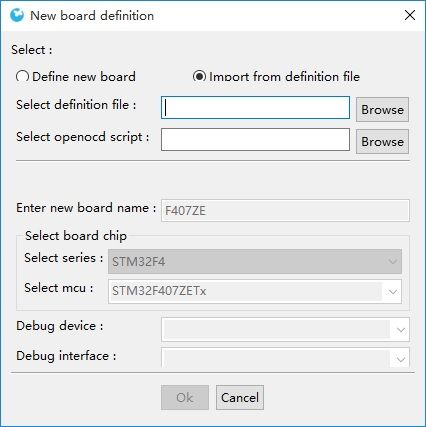

 In Ac6 System Workbench for STM32 environment,new board define have no jlink, my custom board use stm32f4xx.
1  # This is an ac6_f4_std board with a single STM32F407ZETx chip.
2  # Generated by System Workbench for STM32
3
4  source [find interface/jlink.cfg]
6  set WORKAREASIZE 0x20000
7  transport select ''hla_swd''
8
9
10 source [find target/stm32f4x.cfg]
11
12 # use hardware reset, connect under reset
13 reset_config srst_only srst_nogate
 fail to debug

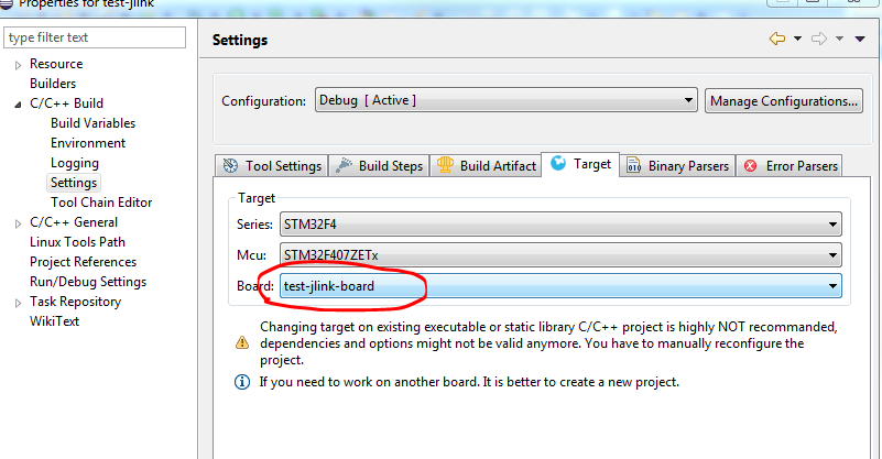

Hi wjandsq,
Ensure that you have selected a board for your project, otherwise the debug session will not run.
0690X00000604sQQAQ.png -Shahrzad-

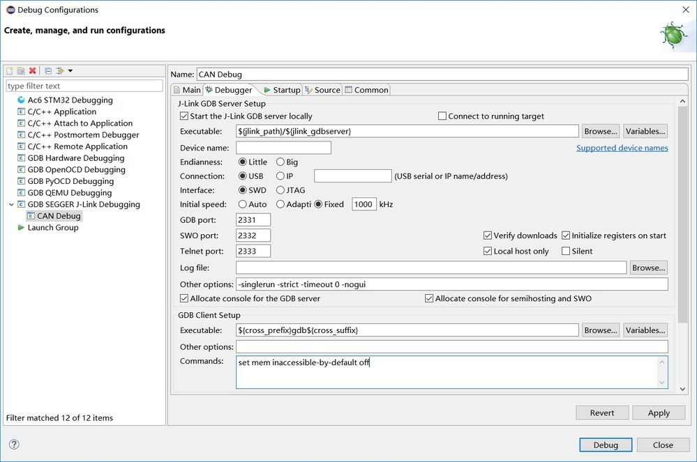

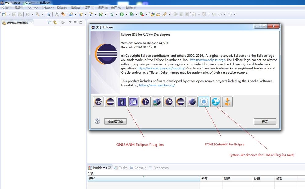

wjandsq

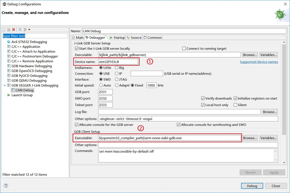

Posted on December 22, 2016 at 08:01
Ac6 use JLink Debug OK!   the modify is
${openstm32_compiler_path}\arm-none-eabi-gdb.exe
