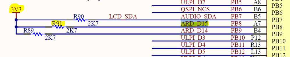

Can I use PB8 and PA12 lines on the  STM32F769NI DISCO board directly to connect to CAN transceiver breakout board?
I had seen a pull-up resistor config on the PB8 line.
Imen GH
you can use pin PA11 instead of PB8.
