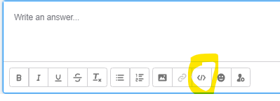

Karl Yamashita
Principal
It's difficult to read your code as is. You need to post your code as a code snippet.
