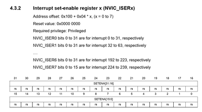

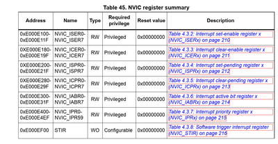

‎2024-06-05 11:40 AM - edited ‎2024-06-05 11:41 AM
From
reading the NVIC registers...?
see state of INTs ...:
etc...

‎2024-06-05 2:53 PM
You can unpick the bit vectors in the NVIC to see which sources are monitored, and which are pending.
It's not going to show how many are active or nested. Or which will follow next as it tail-chains out of the current interrupt. Although you might be able to predict.
You can perhaps add something to count up/down in your IRQHandlers, or score board.
Are you using preemption?
Are you blocking in IRQ Handlers or Callbacks?
