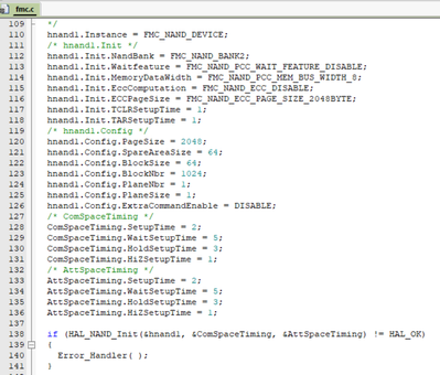

Hi there,
I want to try touchGFX on my homemade board with the STM32F429BIT6 and a band flash chip H27U1G8F2B.
I initial the FMC NAND flash by following the code:

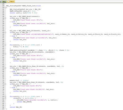

and test the NAND flash as below:

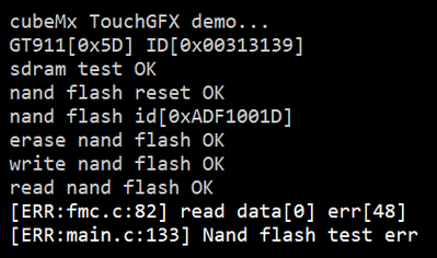

The LOG output is like this(the data value sometimes change, but always data[0] err):
By the LOG, the operation of the NAND flash is successful, but the result is wrong!
Am I making a mistake?
Thanks for your help in advance!

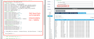

Could anyone demo me how to use the FMC to extend the NAND flash?
I have already tried all the things in my mind.
I can use the SDRAM by FMC normally, but the NAND flash always err...
Thanks very much

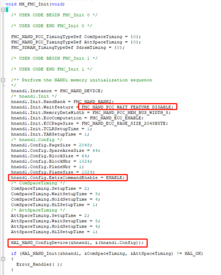

Finally, I find the reason. I think that is a bug of HAL.
The FMC init function needs to add one line for configuring the device parameters.
For me, the code in Red Square is critical!
