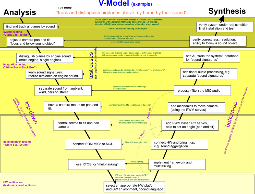

When it comes to "system design" - for my feeling (experience)
  • a good, systematic approach to "analyze" what you want to accomplish (implement) followed by a step-wise, organized "synthesis" (see my picture about the "V-Model")
  • break it down into smaller, fine granular building blocks and implement those, integrate to a system (when "all clear" what to do - you find now how to do).
  • this you can learn just "by doing" it: it seems to me, important is to be "disciplined": not to rush too fast into details when the bigger picture is not clear. And break it down as much as you can, so that the smallest details become clear.
In case of your sensor: you have to "learn", study fundamental things first before starting any coding. For instance: what is this "single wire interface"?, how does it work? how could you test/verify when building/programming? which HW support is there? what would you do in SW? how would you do in SW? ...
It is not magic. It is just an "organized way" to "analyze" and "synthesize". Not jumping ahead and if something is not really clear what and how: iterations (go back a bit again and maybe try to find another, better, easier way).
