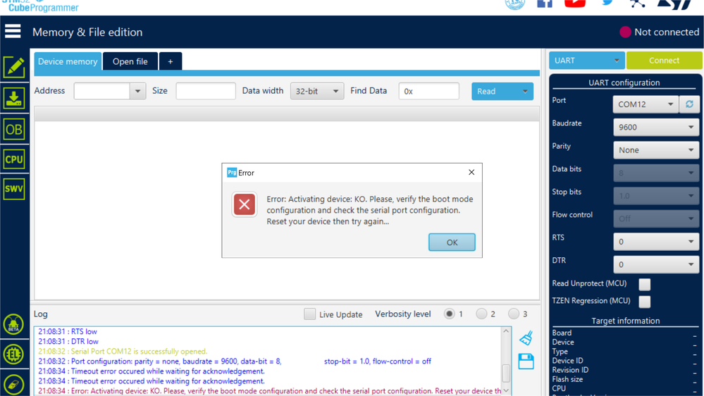

I tried but I couldn't, I pulled boot0 to GND.
I get this message:
I don't have ST-LINK. I really would like to use it normally with the USB cable.

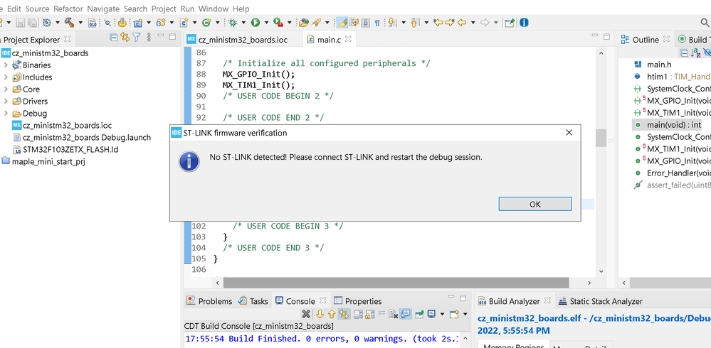

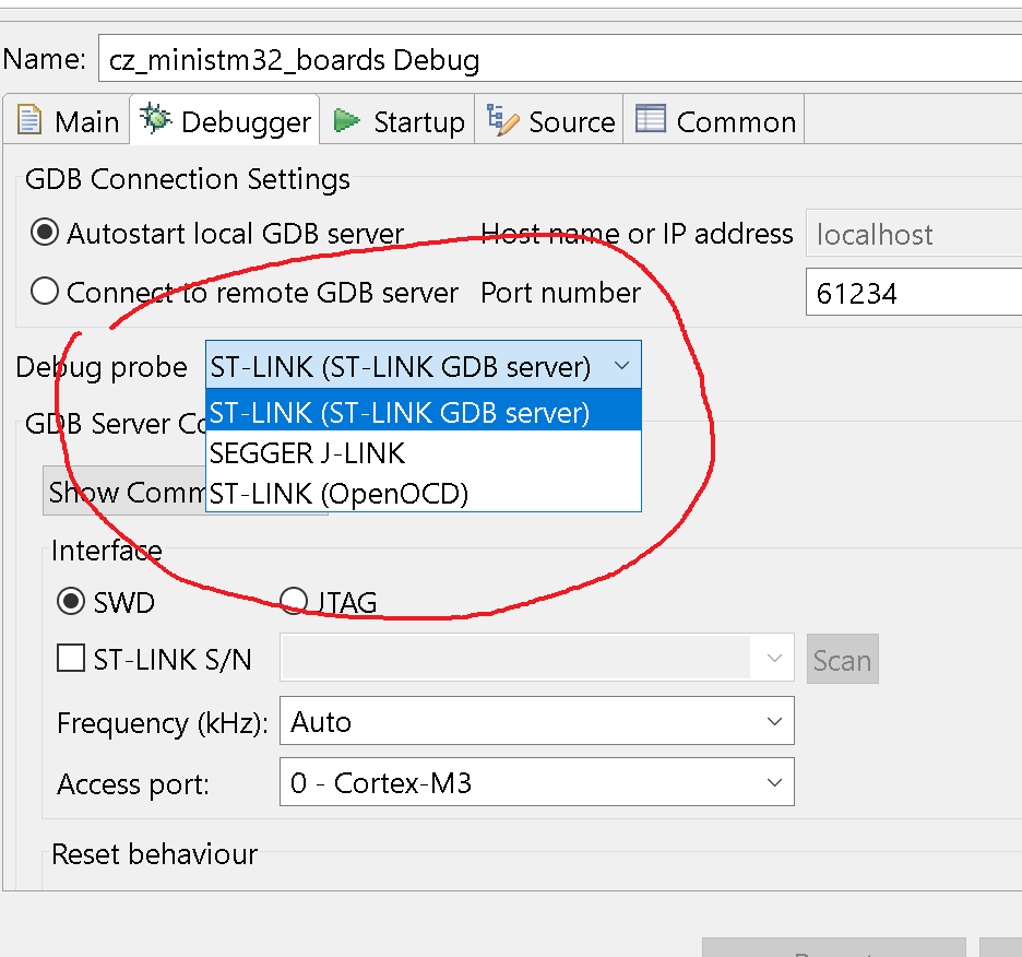

Also in regard to the Cube IDE, I can't use the serial connection as the methods requires external programmers.
Right you DON'T have an ST-LINK, you're not going to be able to interactively do debugging and downloading from the IDE without one, or another JTAG/SWD pod

I installed the software, but I got this error, with setting boot0 to GND.

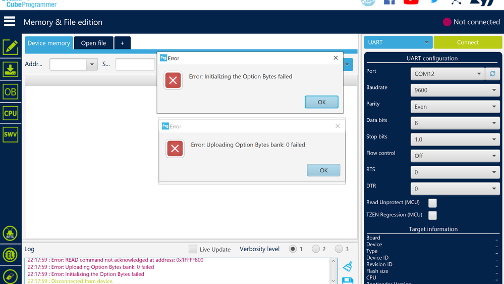

Setting boot1 to GND I got this:
