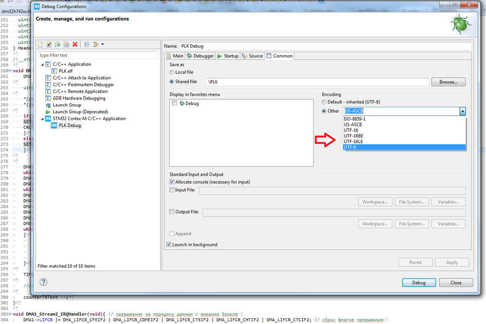

I need to print characters in cp866 format. For printing, I use the printf function with an override of the write function. How can I make character printing using printf in cp866 encoding?

I am using stm32cubeid
This may work:
https://decoding.wordpress.com/2010/03/18/eclipse-how-to-change-the-console-output-encoding/
Alex Golubev
I didn't find cp866 in encoding settings.
0693W000006GtaPQAS.pngWhat am I doing wrong?
Pavel A.
For CP-866 use this encoding table: https://www.ascii-codes.com/cp866.html
Of course if you print that to a serial terminal or similar device it should be able to display it properly.
If the source text is in unicode (utf-8, utf-16...), convert it according to the table.
