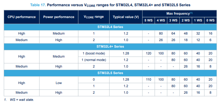

In terms of CPU performance, it depends on the Vcore range, the number of wait states and the expected power performance.
The following table that you may find in AN5138 (Migrating from STM32L4 and STM32L4+ to STM32L5 Series microcontrollers) summarizes the differences:
0693W000006GtktQAC.pngIn order to more enhance the performance for your STM32L5 device, I recommend you to refer to the application note AN5212 (Using STM32L5 Series cache to optimize performance and power efficiency).
