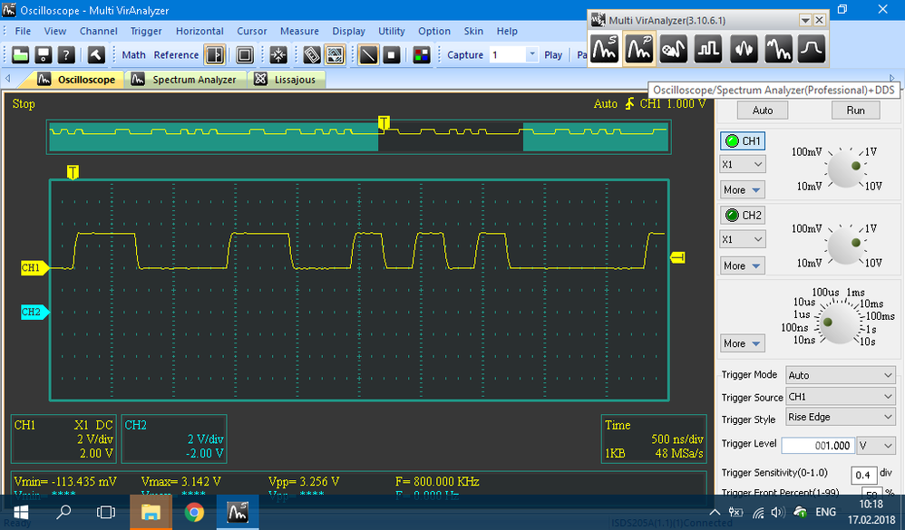

Yes, it is not simple at all. I perform some test:0690X00000609gBQAQ.png
MOVW R0, #(1 << 12)
LDR R1, =GPIOB_BRR
LDR R2, =GPIOB_BSRR
Blink_Loop
STRH R0, [
R2
STRH
R0
R1
STRH
R0
R2
STRH
R0
R1
STRH
R0
R2
STRH
R0
R1
STRH
R0
R2
STRH
R0
R1
STRH
R0
R2
STRH
R0
R1
B Blink_Loop
Other conditions are the same: no interrupts, dma, prescalers etc. Freq is 16MHz HSE (clock every 0,0625us).  And I get this picture in my oscill:
Pulse [0,5 us], Pause [0,75 us], Pulse [0,5 us], Pause [0,5 us], Pulse/Pause [0,25 us] Branch pause [> 1us]
So, the fastest command takes 4 system ticks, branch takes 16 O_o
I really really really don't get it... maybe I'm just to old to figure out brand new things in this SoCs.
But what I actualy figured out, is that the SoC can not complete the task I wanted to... Very sad
