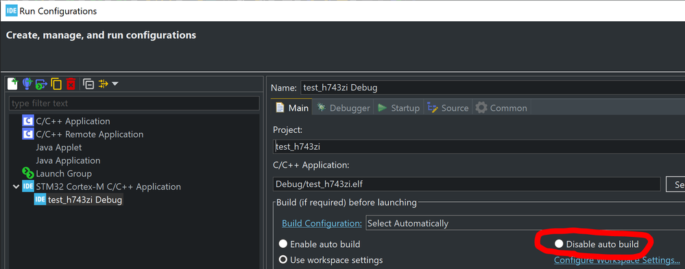

My debug workflow feels pretty inefficient and I was hoping to learn from this community how to improve it. My code framework is built using the embedded CubeMX which leads to default code where the CM7 starts the clocking while CM4 is waiting, then the CM4 comes up and finally CM7 continues after the semaphore was released.
Here is the order of things that bug me most:
A. After compiling and flashing both CPUs, I often need to restart the code for debugging purposes. However, when I stop debugging, it seems there is no other choice but to recompile. Is there a way to restart the code for both CPUs without the need to reflash all the time?
B: Somewhere on youtube I found the sequence how to bring up the two CPUs so I can debug my code while it's running. This works decent but requires a few steps that I have to use each and every time:

A) In Debug (or Run) configuration, you may disable autobuilding here:
To start a debug session without re-downloading it:
Go to Debug Configurations... -> Startup -> select load image -> Edit... -> uncheck Download
Not sure if you asked, but to debug without resetting the device first:
Go to Debug Configurations... -> Debugger -> in Reset Behavior, select "None"
B) Not real sure, but there are pre- and post- build steps which you may be able to use to craft a solution.
C) You could certainly add an "External Tool" which would upload both CM4 and CM7 releases by using the STM32CubeProgrammer CLI. What errors do you get?
Even if you select in debugger settings DISABLE auto build?

@TDK​, @Pavel A.​, thanks for your help. Disabling auto build helped avoid reflashing if the code hasn't changed. Thanks a bunch.
@TDK​, regarding C), it essentially gets stuck in the reset handler. Maybe I should rephrase my question: how do I set up the release process for CM4 and CM7 so that the µC starts out clean upon flashing?
