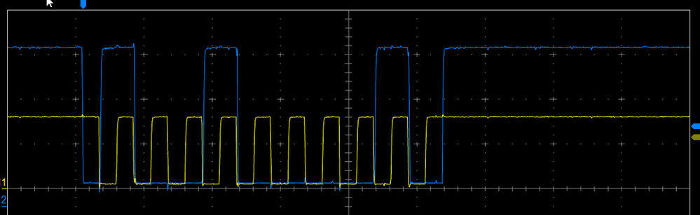

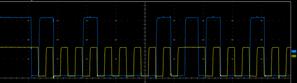

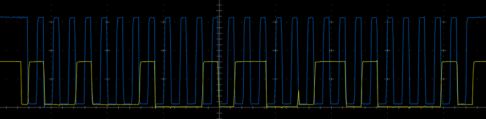

I am currently using a TSC2007 to detect touchs on a screen.
When working in blocking mode this is correctly working as the TSC2007 correctly streches the clock and the HAL correctly waits for the data to be ready
When working with interrupts the HAL fails to wait as a NACK and STOP interrupt is triggered which cancels further transmissions of bytes.
I can avoid the TSC2007 doing the streching by manually waiting a specific amount of time. The probem is that depending on the waiting time the read value is incorrect.
The current solution I am using is calling my TSC2007 driver in blocking mode in a low level priority freertos task
Correct clock streching and read when using HAL_I2C_Master_Receive
Read cancelled by HAL when using HAL_I2C_Master_Receive_IT
0693W00000aJCj5QAG.pngRead correctly done with HAL_I2C_Master_Receive_IT(but incorrect values reported by device) if I wait for an amount of time that requieres
Any idea how to support clock streching in master mode with Interruptions?

Where is the SCL clock stretching in the scope captures? SCL clock stretching means the yellow clock pusle should have missing pusles if master doesn't hold on. The "Stop/Start" bit makes a longer clock high period, it's normal. I'm puzzled.

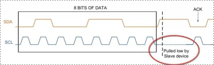

AScha.3
you didnt show any clock stretching , as S.Ma said.
it would be like this : scl kept low by slave

@AScha.3​  Thank you for the clarification. I was misinterpreting the stop+start as the clock stretching. This means that what I am probably seing is the TX of a message that for some reason i failing and then a second message is started to be TX. I will further troubleshoot this issue
