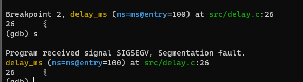

Hello, i'm trying to execute a delay code from CCM memory but the MCU is frezing when enter to 'delay_ms' function. It is the first time that i try this and i don´t know if the linker file, and the startup file modifications are good implemented so i post there the modifications:

Debugging stops when delay_ms executes and MCU freezes
daguirrem
Short answer: CCM on STM32F4x is connected only to D-Bus, dont is posible execute code from CCM :expressionless_face:
