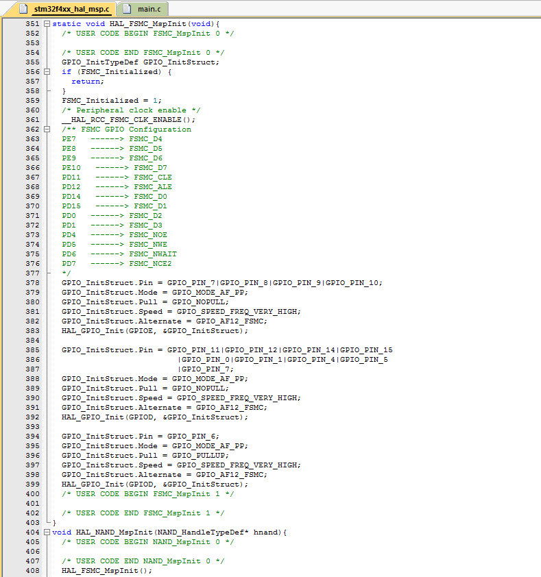

The HAL_NAND_MspInit() is not generated in the stm32f4xx_hal_msp.c when the attached .ioc is used. Therefore the NAND pins are not driven by the MCU and NAND driver is not working at all. How can I enable generation of GPIO initialization code? Or is it a bug?

,After check in your project, I found the generation of GPIO initialized in
stm32f4xx_hal_msp.c and called by HAL_FSMC_MspInit () function

Interesting. Thanks for checking. Maybe it is because I'm running CubeMX on Arch Linux?
I've tried this .ioc on a Windows machine and the FSMC initialization code is generated.
