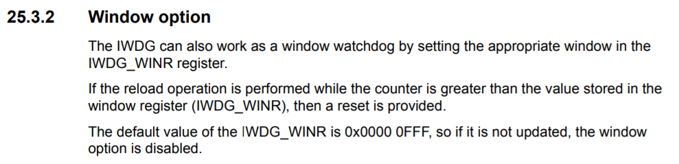

Jaroslav BECKA
Posted on August 29, 2017 at 18:27
Hello Andres,
make sure that the window option is not enabled. Otherwise if refresh is done too early, the IWDG reset will be triggered.

Posted on August 30, 2017 at 13:53
Thinking out loud,
Taking a look at the reference manual:
Default window value is 4095, which means disabled.
I'm using this configuration:
hiwdg.Init.Window = 4095;
hiwdg.Init.Reload = 4095;
Could this be the problem?
Watchdog clear starts the number at 4095 and if it is cleared again it should cause no problem since the reference manual says greater than and this condition would be equal, but who knows.
