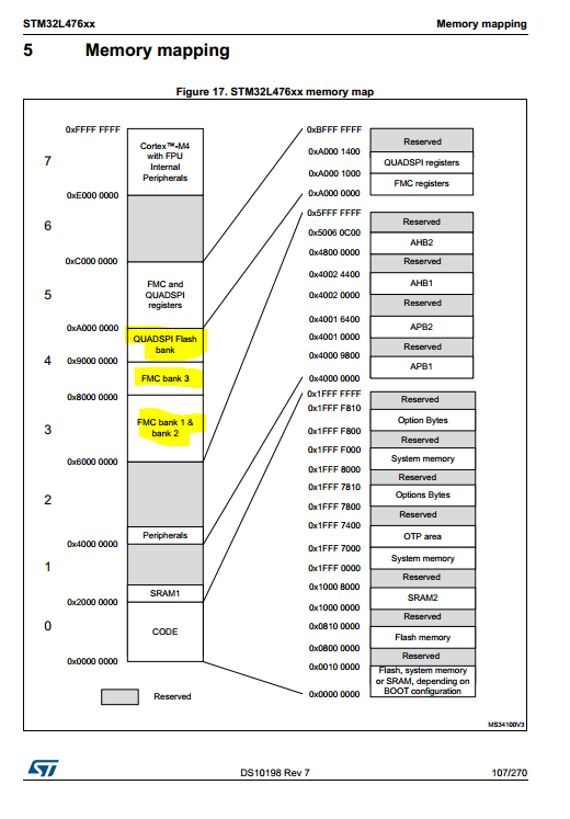

Posted on July 11, 2018 at 11:41
Thanks for a quick response here.
as per this memory mapping diagram below is to consider maximum SRAM calculation.
For FMC Bank 3
0x1000 0000 address available
AddressLine is 16 bit
Dataline is 16bit
Now how I can calculate total supportable SRAM?
Posted on July 11, 2018 at 17:30
Depending on the bank you're looking at 64MB or 256MB, probably more than you can afford to implement externally.

Posted on July 13, 2018 at 16:49
I am going to use STM32L476VGT6 Controller, Now I need to calculate how much external SRAM memory can be interfaced with
STM32L476VGT6
I am going to use 16 data lines.
0x10000000 address available and data bits is 16.
For memory calculation
= 0x10000000  x 16  (0x10000000 converted to decimal)
= 268435456 x 16
= 4294967296 bits
= 4194304 Kbits
= 512 MBytes
So we can add up to 512MB SRAM external to
STM32L476VGT6.
Please Correct me if something wrong calculation is done.
Posted on July 13, 2018 at 17:42
As I said before the banks are 64MB and 256MB wide. With the right techniques I could interface 10's of GB, or more, RAM to the L4 part.
Ok, but people don't put that much SRAM externally because it's the most expensive way to do it. I'm thinking you're cheap, or tightly budget constrained.
