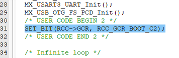

I'm implement IAP in Nucleo-H745ziq.
So. when i into application then cm7 trigger(boot) to cm4.
cm4 can't boot in keil but in stm32CubeIDE can boot.
SET_BIT(RCC->GCR, RCC_GCR_BOOT_C2);

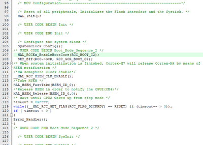

You need to include code in the CM7 project that enables the booting of the CM4 core using the HAL_RCCEx_EnableBootCore() function from the STM32H7 HAL library.
Ensure the right memory area is selected for the CM7 core, such as Flash at 0x08000000 for Boot address 0.
Build the CM7 project and load the binary onto the target device.
You need to configure the CM4 Project and ensure the memory area and startup code are appropriate for the CM4 core. Then, Build the CM4 project and load the binary onto the target device.
Load both CM7 and CM4 projects in Keil and start the debug session for each core. You should start the CM7 project first, which will then enable the booting of the CM4 core through the code you added. Then, start the CM4 project.

This doesn't work either.
I'm check already flash cm7 boot addres
HAL_RCCEx_EnableBootCore(RCC_BOOT_C2);
STM32CubeIDE Application Projcet it work cm4
But keil Application Project can't boot cm4

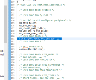

I'm tried again Today in STM32CubeIDE.
First. I'm made new Application Project.
CM7 in main.c I'm code just one line SET_BIT(RCC->GCR, RCC_GCR_BOOT_C2);
But I can't boot cm4.
However, I'm tried Changed CM7 timer TIM4 from SYSTICK
Then CM4 can boot.
You know why that worked?
Now, My Keil application project can trig boot for cm4
