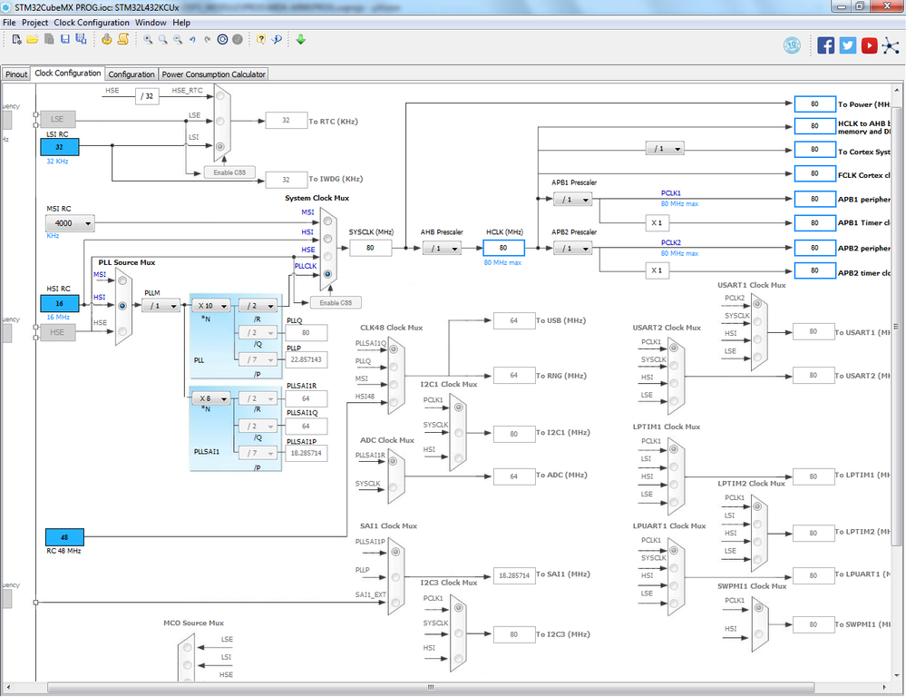

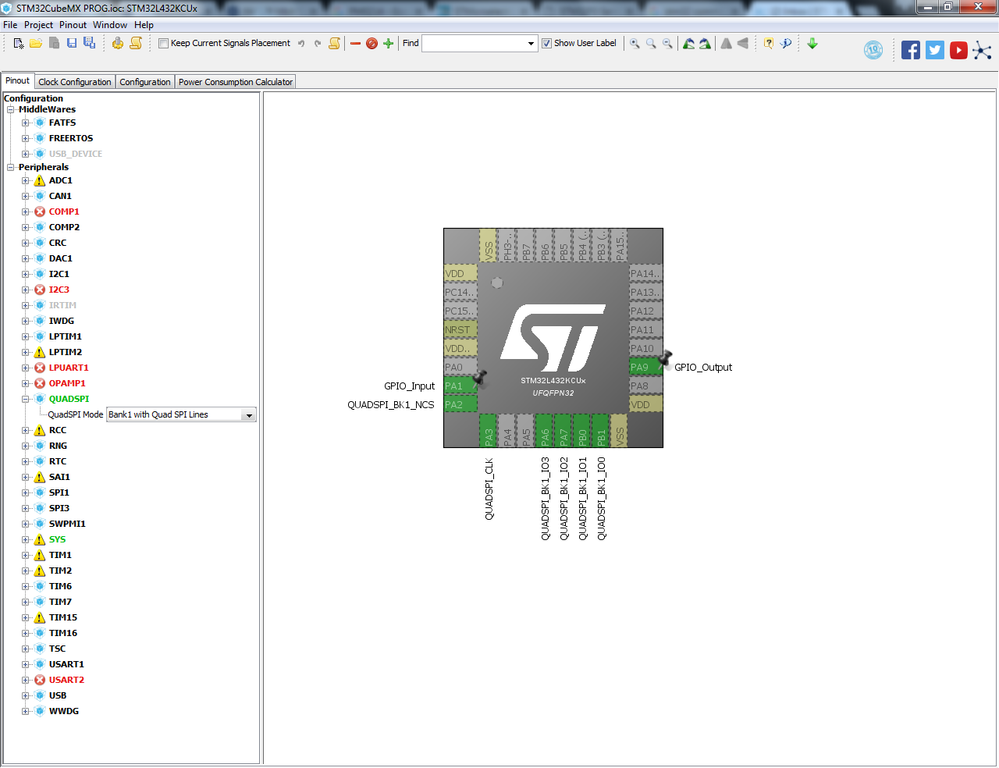

how to achieve the clock frequency to 48MHZ for QSPI
chethan sk
Posted on May 26, 2018 at 11:33
I AM USING SYSCLK = 80MHZ
AHB BUS CLOCK = 80MHZ
PRESCALER FOR QSPI = 0
and i am getting QSPI CLOCK FREQUENCY to 8 MHZ
i am using  STM32L432KC controller.
4 REPLIES 4
Posted on May 27, 2018 at 13:04
Doesn't seem right.
Have you confirmed 80 MHz via MCO(PA8)
Perhaps show initialization code
T J
Lead
Posted on May 28, 2018 at 13:08
try prescaler of 1 or 2
