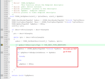

I have read the example and this tutorial carefully.
But my program always can't work, the code is stopped at USBD_GetEpDesc() because pdesc->bDescriptorType always NOT equals to USB_DESC_TYPE_ENDPOINT
I am not skillful at USB, but I can sure the hardware is work well, as I have a project can do that thins.
If need, refer my project at attachment.
Thanks for your help!
Junde
Senior III
For MDK IDE, the USB related code must compiled by "MDK compiler V5", the binary by "MDK compiler V6" will NOT work!
Demo reference: https://github.com/ShadowThree/STM32V6_extFlash_SDcard_FatFS_Udisk_Demo
