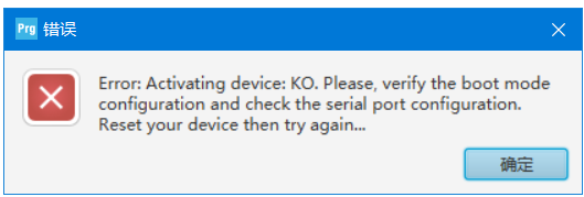

How should i use UART to download firm? the mcu is STM32F401VBH6,and i have sent the boot0=0. the download tool is stm32cube programmer.

The booto now is 1,but it still show this error:
Mike_ST
What error ?
Pwang.21
The below:
Has the chip/board been test and programmed via JTAG pins?
Which UARTS and pins do you have connected, and too what?
Are other devices connected that might be signalling on other pins?​

My configuration as below:
Boot0=1,boot1 not configure
USART1
8-bits, even parity and 1 Stop bit
could you help to confirm boot1=0 is necessary?
This is what section 27.1 of AN2606 is saying: "The STM32F401xB(C) bootloader is activated by applying pattern1"
If I remember well, if boot1 is pulled to 1, the MCU boots from RAM.
