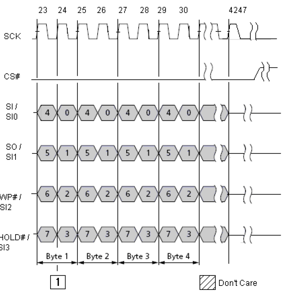

hospi.Init.SampleShifting = HAL_OSPI_SAMPLE_SHIFTING_NONE;When I set OSPI1 to OSPI_QUAD_MODE, the write-read-comparison failed.
I came across an article suggesting that I should select an appropriate 'MemoryType' based on the data transfer order. However, I'm unsure about which memory type to use in my case.
Could you please assist me in identifying the correct memory type?
Flash spec: https://www.issi.com/WW/pdf/37-38SML01G1.pdf
It is how data is transferred in QSPI mode from flash.

Not so sure about "command necessities 7 clock"?
Data is transmitted in 4-lines (QSPI) mode. All the command / addresss are transmitted in 1-line mode.

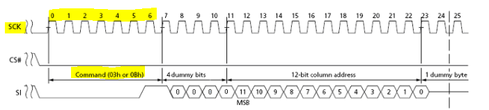

2023-05-22 6:08 AM - edited 2023-11-20 6:04 AM
Hello @Glee.4 ,
To clarify my last comment, this ISSI NAND memory requires 7 SCK for the command as shown in the below figure.
But, it is mentioned in RM0456 and precisely in Octo-SPI interface (OCTOSPI) section, for the command phase 1 to 4 byte instruction is transmitted.
Thank you.
Kaouthar

2023-05-29 3:02 AM
Hi @KDJEM.1 ,
I have succesfully accessed ISSI NAND memory in single SPI mode on OSPI interface. Commands and data are transmitted in single SPI mode without issue. (You are right. It doesn't make sense to transmit 8bits command in 7 SCK. Maybe the ISSI spec is wrong or the 4 dummy bits comming after the command cycle make it right. :) )
In my use case, even though OSPI is set to quad-SPI mode to transmit data, I will still transmit command in single-SPI mode. So I am more concerning about the data phase instead of instrcution phase.

2023-06-01 6:49 AM
Hello @Glee.4 ,
If you think that the ISSI datasheet is wrong it must be contact the proved memory.
For the OSPI , the choice of memory type is based on data ordering.
But for the QSPI, when the memory is supported by the Octo-SPI interface, you can choose any memory type. The memory type has not affect the function for the QPSI.

2023-06-04 8:51 PM
Hi @KDJEM.1 ,
The command CLK doesn't really bother me since I have no isuse to send command and get correct response in single SPI mode on Octo-SPI interface.
I tried different memory types to transfer data in QSPI mode but it doesn't work.
That's why I posted this question to ask if data ordering matters in QSPI.
