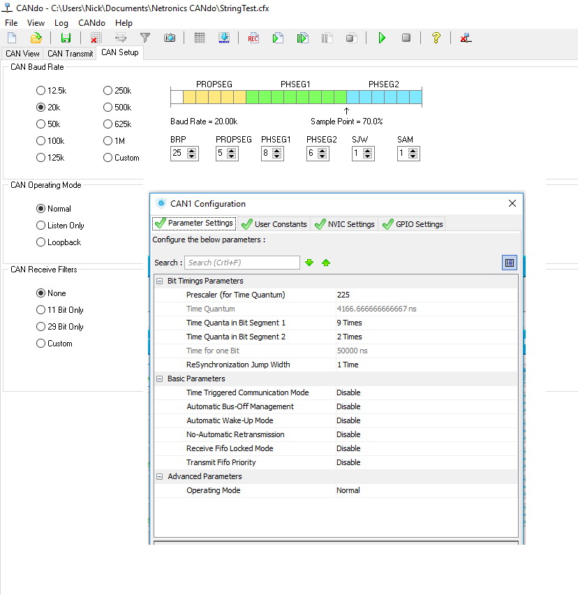

Hello friends,
What is the lowest Canbus speed ? And how can I adjust the speed
I need a Low and safe speed
Please guide me
MCU = STM32F407ZET6 , HSE = 8Mhz , SysCLK 168Mhz
Thanks for all of you

Posted on January 11, 2018 at 21:58
Use very large prescaler

Posted on January 12, 2018 at 02:11
I used 20KHz trying to run 1km..
here is the screen shots of the cube and the CanDo setup
