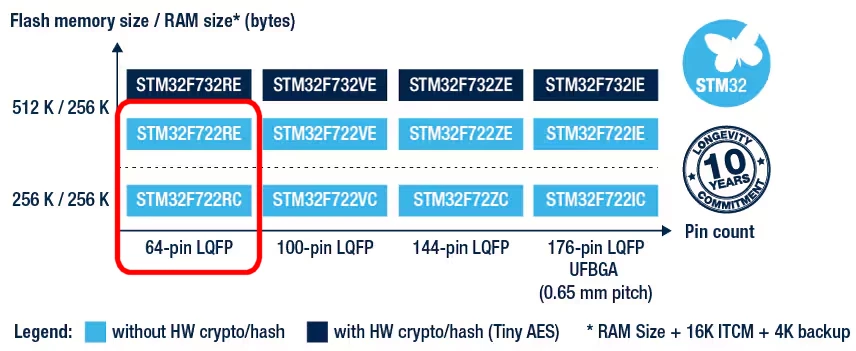

I'm trying to use the (sic) 64pin STM32F722 part
There are two:

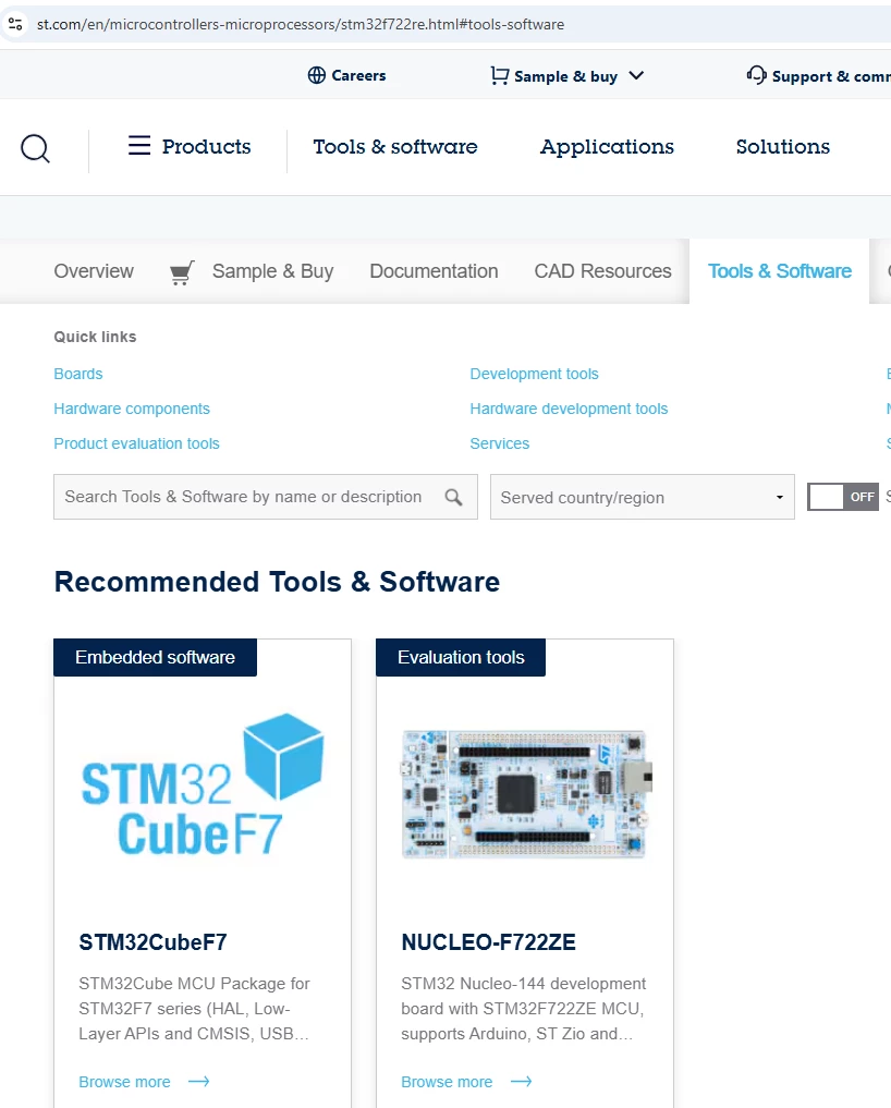

The STM32F722RE Product Page suggests the NUCLEO-F722ZE:
You can get the schematics for that from its Product Page - on the 'CAD Resources' tab:
https://www.st.com/en/evaluation-tools/nucleo-f722ze.html#cad-resources
