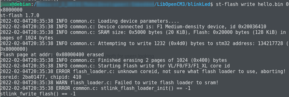

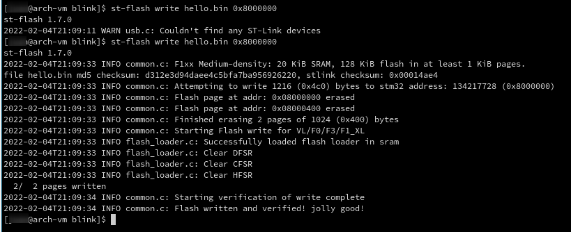

Hi, I'm testing libopencm3 libraries on a stm32f103c8t6 board. I have an erro that seems the st-flash tool is not able to record in the SRAM when I use a vm Debian GNU/Linux 10 (buster) , but when I use a VM with arch Linux the process is succesfully.
JG
Attached images of both systems and I really appreciate suggestions to understand and be able to solve the problem in debian.
