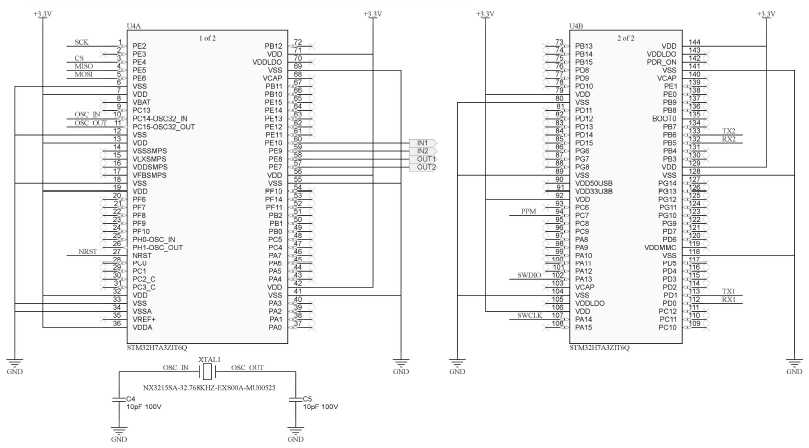

Hi everybody. I use a STM32H7A3ZI. In my schematic I forgot some capacitors and I can't flash it using a ST LINK V2. Could anyone tell me a basic schematic with essential components and nets to work with it? Thanks.
MSivi.1
3 REPLIES 3
VCAP are critical for the design and internal power supply to work. One 2U2 on each, or tied and using a 4U7
Pull BOOT0 to ground (10K) so it reliably boots
Or honestly at least a read / review of the Data Sheet
