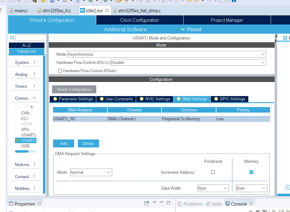

Hey guys, im new to st and im having hard time with receiving data VIA uart. im trying to receive data with unknown length, decided that the best thing for my application would be idle line interrupt.
DSosk.1
my problem is that the DMA only writes to the first address of the buffer,
means that when i look on the buffer, the last byte of the message is stored in the first place of the array, and the rest of the data is overwritten.
what could be the problem, what am i missing?
/* USER CODE BEGIN 2 */
  __HAL_UART_ENABLE_IT(&huart2, UART_IT_IDLE);   // enable idle line interrupt
  HAL_UART_Receive_DMA(&huart2, rxBuf, 255);
  //__HAL_DMA_ENABLE_IT (&hdma_usart2_rx, DMA_IT_TC);
  /* USER CODE END 2 */

The HAL_UART_IRQHandler() will call your call-back routines.
You should definitely avoid blocking HAL_UART_Transmit() function and printf() in the IRQ Handler or call-back routines.
There are significantly cleaner and more efficient approaches to IRQ/DMA than those used by the HAL implementation
Hi. Have you configure DMA with destination address increment by byte?
yup
New to ST, start simpler, get it working with IRQ, the thing interrupts with every byte, for variable sized packets use a state machine to determine size and packetize to processing task. Assuming someone thought out the protocols so it doesn't need inter-message gaps to demux. ​
