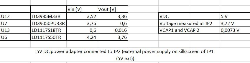

Measure the voltages off the regulators.
Measure the voltages on the VCAP pins/capacitors.
Chances are you'll have to replace the F746 chip as you've likely vaporized the metalization and poly-silicon in the current's path on the die. Much better fuses than the PCB traces and gold wires.
The ST-LINK USB connection is to an F103 chip, but does suggest that 3.3V regs are working still.

This is what i measured today
