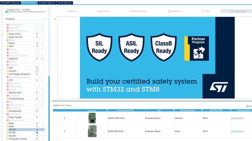

Max available serial (RS232) for STM32 Eval boards is two.
You can use ST-MCU-FINDER to explore the STM32 portfolio and find product that will fit your needs.
For example, you can search products in "Board Selector" with update value in RS-232.
Note that ST-MCU-FINDER feature is included in the STM32CubeIDE and STM32CubeMX tools.

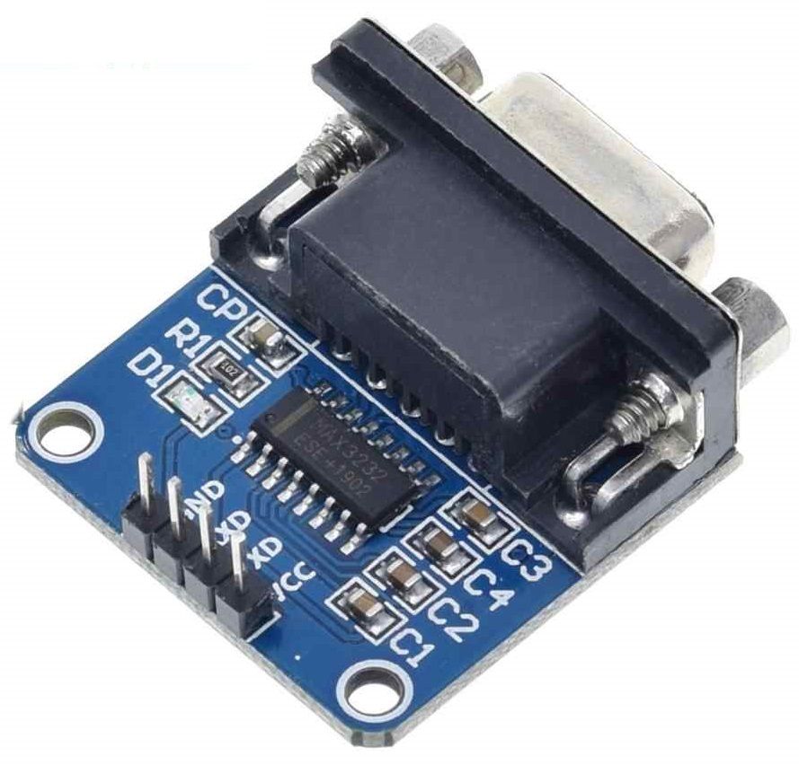

RS232 is a bit dated, most applications today use MCU to MCU level connectivity at CMOS levels.
I would recommend using a NUCLEO-144 board, finding a handful of UART pairs, and then wire in simple RS232 DB9 w/MAX3232 adapters from eBay/AliExpress or you're local vendor of choice.
https://www.aliexpress.com/i/32786765185.html
Or even simpler, wire up few cheap TTL to USB adapters.
