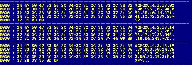

The receiver isn't sending the \r\n characters literally, it is sending them as 0x0D and 0x0A bytes, like $ is 0x24
So this was super helpful, I did have UBX packets being sent, and that was causing all kinds of problems as I was building under the assumption that I only had the one message type enabled.
I cracked open the interface manual that goes with this chip and I think it is actually sending \r\n literally. 0693W00000DqIcYQAV.png
