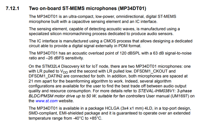

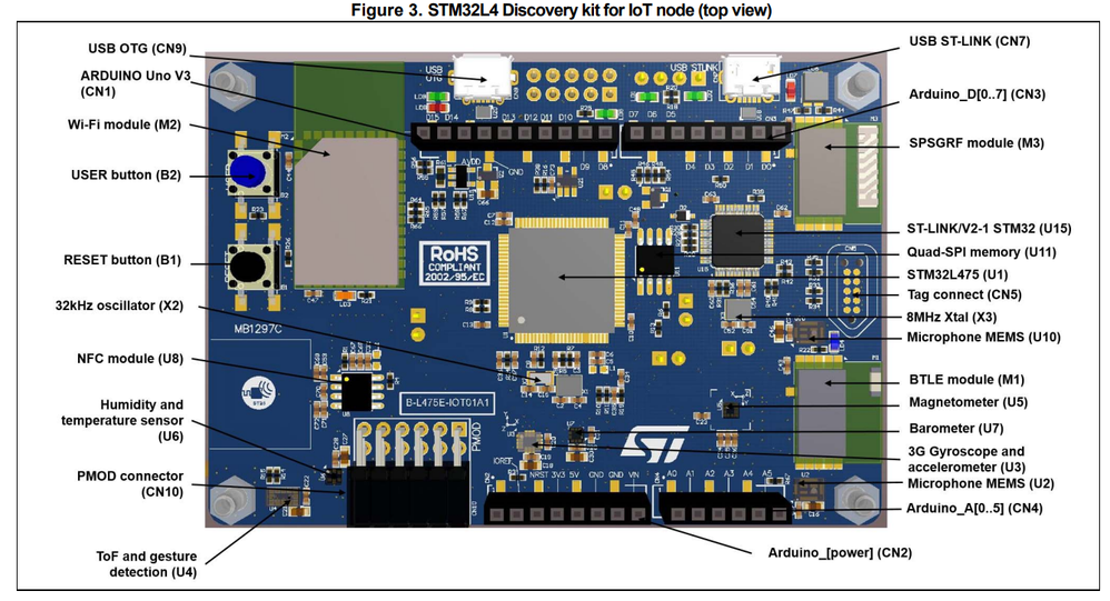

I was a bit surprised to find that there aren't really any tutorials which can tell me how to read the PDM microphone that is onboard the Discovery Board (the physical MCU board has a PDM MEMS microphone soldered in).:
0693W00000KcOmtQAF.png0693W00000KcOnNQAV.pngAfter looking at the datasheet for the board, I managed to find the pins which are allocated to the MEMS microphone by default:
