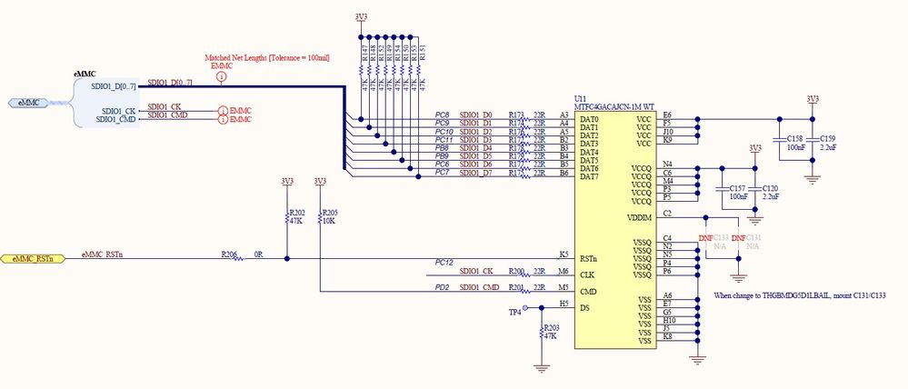

Materially similar to the SDIO/SDMMC interface you're familiar with. Probably 4-bit available of F4, will need custom SDIO drivers to support differences
Use the 3 or 3.3V VCCIO
