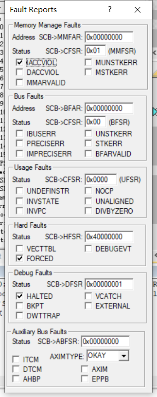

Problem: When I execute the code "JumpToApplication();", it will be "Hardfault"
Thanks!
more information:
0. I have checked that the data in the SRAM(0x30000000) is the same as the bin content compiled by my application.
1. The fault reporter(debug):

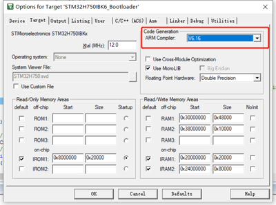

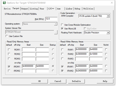

LOL, The reason is my customer bootloader is use "V6.16 ARM compiler", and the application uses "V5.06 ARM compiler".
Boot compiler:
App compiler:

Looks like jump to 0 (corrupted pointers or variables on stack?). Try to debug, single step from your bootloader to few first instructions of the app reset handler.
Boot compiler:
App compiler:
