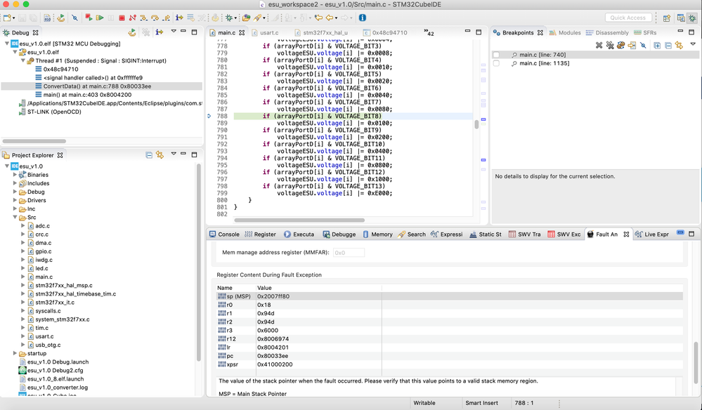

My code is generating a HardFault condition, is not every single time it pass the main loop, but after the first 5s it stops.
The Hardfault not happen every time in the same line, that is what have been so difficult to track down, but it always stops at the address 0x4df94710.
The code is apparent to be fine, I think something is corrupting my stack.
Can someone help me.

Luiz Roque
Hi, guys, here are the registers at the fault.
Is it something related to my stack been corrupted? How can I track it down?
Ok, that's a subset of the registers, the index is in R4 from the prior disassembly, but it is halfway through some code that is doing materially the same thing.
You'd perhaps fill the stack with a known pattern you can see in registers later, or check in a data dump of the stack area.
Determine which interrupts you have firing. Perhaps output a character to the terminal at entry/exit from those interrupts to identify any pattern to the failure.
Check your (excessive) use of auto/local variables in these interrupts and callbacks, and functions called inside them.

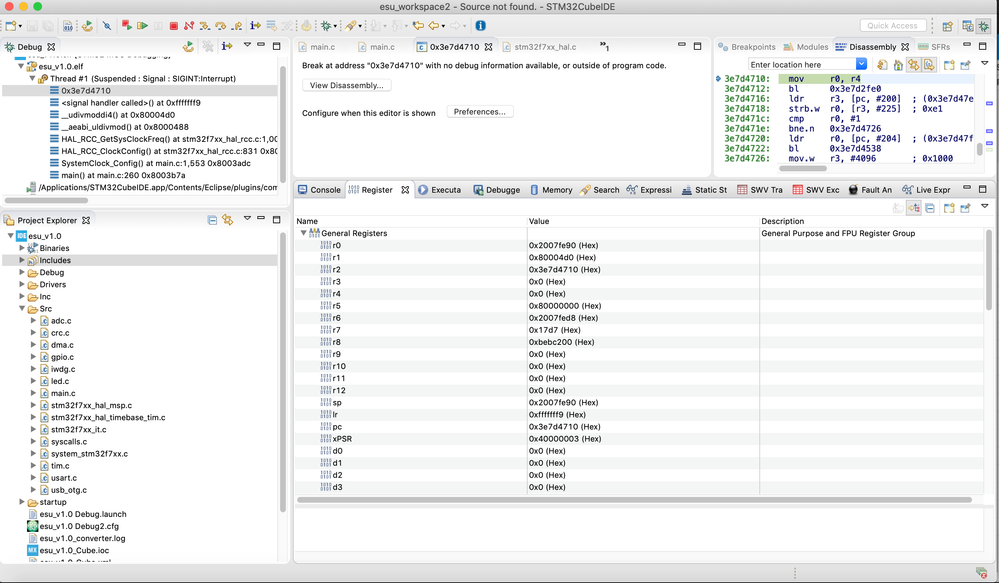

Luiz Roque
I thing maybe is some related with the RCC or system clock, or even my HSE clock, because some times I'm getting hardfault during HAL_Delay, or during clock init. Liked the photo below.
Looks to be branching to an invalid address (pc via r2), perhaps clash of stack/heap

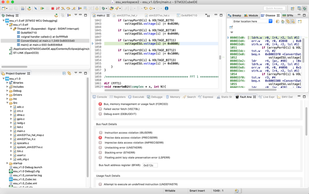

generally it is an 'out of bounds' issue or power supply noise.
I would suggest its one of these lines, causing the problem:
a_fft = temp1 + (temp2*indiceWD);
could you check this value before you execute these lines ?
  1.
  2. Xf[a_fft].real = (voltageFFT[b_fft].real + fftAux2.real);
  3. Xf[a_fft].imag = (voltageFFT[b_fft].imag + fftAux2.imag);
then this line,
b_fft = a_fft + d_fft;
could cause it on these lines,
4. fftAux2.real = ((voltageFFT[b_fft].real*fftAux1.real) - (voltageFFT[b_fft].imag*fftAux1.imag));
5. fftAux2.imag = ((voltageFFT[b_fft].real*fftAux1.imag) + (fftAux1.real*voltageFFT[b_fft].imag));
I would check if a_fft and b_fft and voltageESU.len are within your array size. before you use them...
all the new linux core has hardset bounds or serious bounds checking.
The PWM would be asynchronous to the systick,
I guess that the PWM/DMA interrupt has priority over the systick, so thats why you can go into hardfault during systick.
do you have a call-stack view ?
should be able to backtrack the function that is causing the hardfault.
easily checked by commenting out lines that use the a_fft b_fft or d_fft or voltageESU.len indexing.
anyhow, if its not those variables, generally it is an index out of bounds in my experience.
if you are getting a hardfault after reset, in clock init, then you may have insufficient capacitance on your PCB,
can you check the voltage rails on the processor ? and the Vcap pins ? do you have a scope ?

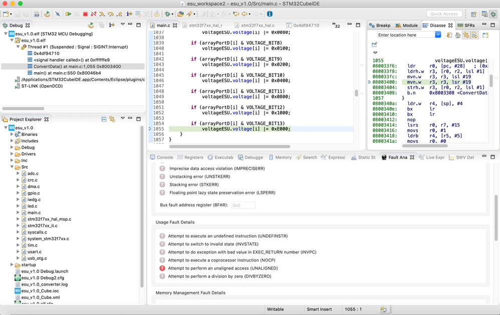

Luiz Roque
Hi, I did not understand, can you be more specific?
I looked up at links you sent, the only thing I found useful is to set my own hardfault handler, but how is this apply to my case? Since the code do not go to the hardfault , it goes to an invalid address.
I set a big min stack and heap
