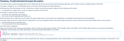

Have you made the following step before running your code extracted from the readme file from the H5 Cube Firmware (project template Trust zone enabled)
The hard fault will disappear
Best regards
Lobna
I do have the internal flash configuration set to bank1 secure, bank2 non secure.
My configuration was
-SECWM1_STRT=0x00 SECWM1_END=0x7F
-SECWM2_STRT=0x7F SECWM2_END=0x00
Just in case i now swapped it to whats shown in the picture (
-SECWM2_STRT=0x01 SECWM2_END=0x00 ),
but i am still getting the same hardfault when trying to run cmox_encrypt() in Secure Area.
