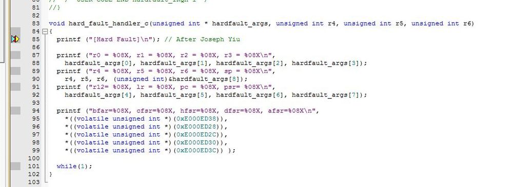

In Keil, I do it this way..
HardFault_Handler\
PROC
EXPORT HardFault_Handler
TST lr, #4 ; Determine correct stack
ITE EQ
MRSEQ R0, MSP ; Read MSP (Main)
MRSNE R0, PSP ; Read PSP (Process)
MOV R1, R4 ; Registers R4-R6
MOV R2, R5
MOV R3, R6 ; sourcer32@gmail.com
EXTERN hard_fault_handler_c
B hard_fault_handler_c
ENDP
void hard_fault_handler_c(unsigned int * hardfault_args, unsigned int r4, unsigned int r5, unsigned int r6)
printf (''[Hard Fault]
''); // After Joseph Yiu
printf (''r0 = %08X, r1 = %08X, r2 = %08X, r3 = %08
X'',
hardfault_args[0], hardfault_args[1], hardfault_args[2], hardfault_args[3]);
printf (''r4 = %08X, r5 = %08X, r6 = %08X, sp = %08
X'',
r4, r5, r6, (unsigned int)&hardfault_args[8]);
printf (''r12= %08X, lr = %08X, pc = %08X, psr= %08
X'',
hardfault_args[4], hardfault_args[5], hardfault_args[6], hardfault_args[7]);
printf (''bfar=%08X, cfsr=%08X, hfsr=%08X, dfsr=%08X, afsr=%08
X'',
*((volatile unsigned int *)(0xE000ED38)),
*((volatile unsigned int *)(0xE000ED28)),
*((volatile unsigned int *)(0xE000ED2C)),
*((volatile unsigned int *)(0xE000ED30)),
*((volatile unsigned int *)(0xE000ED3C)) );
while(1);

If you want to replace the Hard Fault Handler, then you're going to need to cut-n-paste the new assembler code into startup.s and replace the current handler (ie remove/rename) with the alternate C code I've provided. You'd also need to provide sufficient hosting in your system to support printf() output to a USART or SWV debug channel.
I'd recommend reviewing Joseph Yiu's Cortex-Mx books, and ARM's TRM (Technical Reference Manual) for the core you are using.

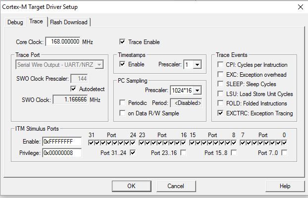

Hi Clive1,
Yestarday I had some problems to replay you. I'm thirty but only 8 month ago I'm working with STM32 devices. I'm new in Keil and with this environment. I've tried your advice, but I have other problem. I can't printf. I have an ULINK2/ME which can SWD but I don't know why when the system arrives at printf it hangs.RCC_OscInitStruct.OscillatorType = RCC_OSCILLATORTYPE_HSE;
RCC_OscInitStruct.HSEState = RCC_HSE_ON;
RCC_OscInitStruct.PLL.PLLSource = RCC_PLLSOURCE_HSE;
RCC_OscInitStruct.PLL.PLLM = 8;
RCC_OscInitStruct.PLL.PLLN = 336;
RCC_OscInitStruct.PLL.PLLP = RCC_PLLP_DIV2;
RCC_OscInitStruct.PLL.PLLQ = 7;
HAL_RCC_OscConfig(&RCC_OscInitStruct);
What is it happen?
Certainly the stack is defined as 0x900
2016-08-04 08:57 AM
Ok, but where does is ''hang'', the debugger provides a means to stop execution and inspect the instructions and state.
