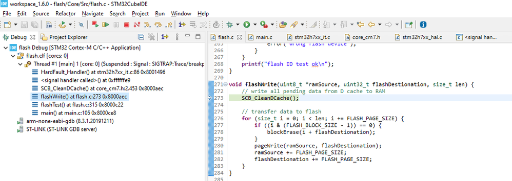

I had some wrong bytes when transferring data over SPI, so I tried to clean the DCache. But I get a hard fault if I do this:
0693W000008xqbnQAA.pngI'm using the NUCLEO-H723ZG board.

And is D cache enabled?
Try this:
    if (SCB->CCR & SCB_CCR_DC_Msk) {
        SCB_CleanDCache();
fb
Thanks, looks like it was not enabled, because with your test, it works. It was a project created from STM32CubeMX. Is it possible to enable it in CubeMX? I added SCB_EnableDCache() in the main function, and this solves the problem as well.
