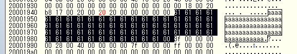

     pData == &receive_str[0] == 0x2000194c
     Size == sizeof(receive_str) == 64

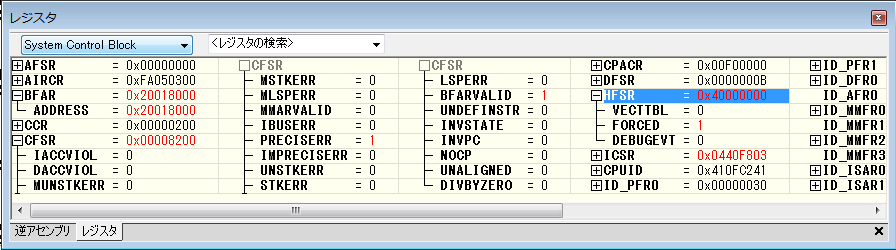

until 63rd character receive there is no problem. I typed 'a' 63 times.
The black backed area is buffer for  Receive_DMA.

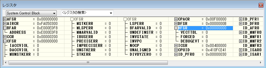

However, when I type 64th character 'b' Hard Fault raised as following.
'b' exists at  receive_str[63]  by DMA.
PRECISEERR is 1 , BFAR = 0x20018000.
It looks unwanted memory access to 0x200018000, did not such access.
DMAC is still transfers Rx data correctly.
I typed 'c' 3times, then the buffer is overwriten circulariy as expected.

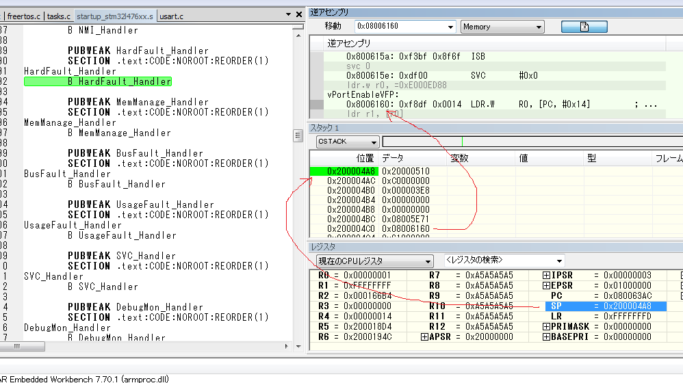

At the time, I lookd stack.
Does anyone know my mistake, or how to workaround?
