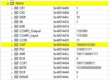

I would like to execute some code in an interrupt handler when the pulse value for TIM16 is reached. But for some reason, none of the interrupts provided by HAL seem to trigger for this event.
I have setup the timer using the configuration tool with the following:
(TIM 16 running off an 8MHz clock)
CH 1 - PWM Generation CH1
Prescaler - 799
ARR - 9999
Mode - PWM mode 1
Pulse - 2499
I assigned pin PB8 to produce the PWM signal.

P.S. Here is a TIM16 register dump
HAL_TIM_PWM_PulseFinishedCallback is called when the pulse value (CC1) is reached, so that's the one you want.
HAL_TIM_PeriodElapsedCallback is called when the timer updates. It is enabled with HAL_TIM_Base_Start_IT. It sounds like you may want this one as well?
HAL_TIM_PWM_PulseFinishedHalfCpltCallback is enabled in HAL_TIM_PWM_Sta1rt_DMA and similar and doesn't do what you want here.

If I recall correctly:
HAL_TIM_PeriodElapsedCallback is called when the timer reaches the value stored in the 'reload register' (This is when the timer 'updates' and determines the frequency of your PWM signal)
As TDK has said above HAL_TIM_PWM_PulseFinishedCallback is called when the timer reaches the pulse value stored in the C&C register. This is responsible for your duty cycle.
Don't foget that if you want HAL_TIM_PeriodElapsedCallback, you must call HAL_TIM_Base_Start_IT and if you want HAL_TIM_PWM_PulseFinishedCallback, you must call HAL_TIM_PWM_Start_IT. To have both callbacks you must call both 'start' functions.
