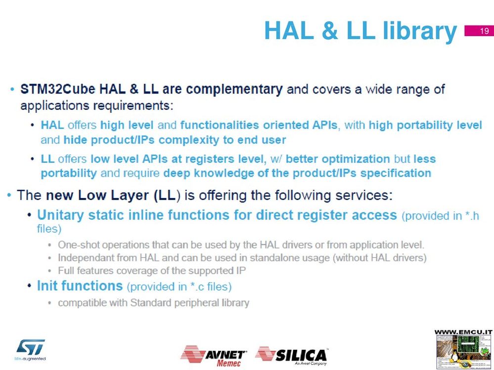

Hello there,
I was getting quite used to HAL for about a year now. Then I was trying to find out something about modbus mode in STMF0 and I find this ''Low Level API''. I cant seem to find any of its functionality in my current CubeMx generated code for F0 (CubeMx version 4.16.0). I see that I can download a new package for F4 and a new version of CubeMx 4.17.0. Would that bring the LL functionality? Also, if yes, would it affect my project that are written in HAL so far? I would appreciate all hel regarding this issue.- Mark as New

‎2021-11-22 12:02 AM
the difference between LL and HAL
