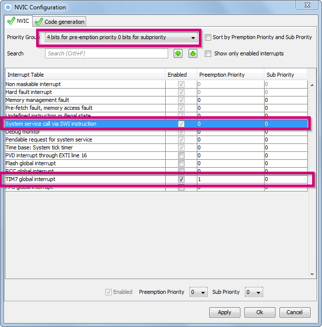

Using current HAL-software generated with cubemx on stmf4_discovery board.
I use TIM7 as an interrupt generating timer, set at say 100 msec.
In the ISR I do:
i = HAL_GetTick();
delayms(12); tt = HAL_GetTick()-i;where delayms is a busy waiting loop (normally our application code would go there).
And tt is a global int.
I would assume that tt would normally be something like 11, 12 or 13.
But it is always 0.
The (default) interrupt priority of TIM7 is much lower (higher number) than Systick, so why isn't the system tick not updated in that 12 msec?
Or am I missing something?

‎2016-12-08 6:35 AM
The priority -1 on systick is taken in care only when the two interrupts have same settable priority.
By default in CubeMX the Systick is set to 0.
If you are using the CubeMX project please check the systick an tim7 priority in the project and the group priority option.
If the group priority do not have any bits for preemption priority then the interrupt cannot preempt second active interrupt.
If you are not using the CubeMX please check the HAL_NVIC_SetPriorityGrouping and HAL_NVIC_SetPriority functions if they using correct priorities for systick and tim7 and correct group priority.

‎2016-12-08 3:37 AM
Hi
Achterop.Sietse
,IT is the normal behaviour in your configuration status since the Systick can not preempt the Timer to make a delay. As a solution you can do one of the following scenario:
Make the Systick the highest priority ( if it make a problem in your application, tryto pause and resume it using the hal function)
When entering the ISR , inverse the priority of the systick and Timer
Use another timer to make the delay inside
delay ms
If the response is helpful , press the correct button down
-Walid F-

‎2016-12-08 4:33 AM
I think I did follow the first scenario of Walid, and I just checked whether the Systick ISR is called when in the TIM ISR.
It is NOT called at all.
I did not change any priority, so the priority of Systick (-1) is much higher than that of TIM7 (55), so the systick should interrupt the TIM7 isr!
So I still don't understand it.

‎2016-12-08 7:21 AM
Thanks! Thats it.
I wrongly mistook the index in the interrupttable as the priority:(
It's working like a charm now. Thanks again.
