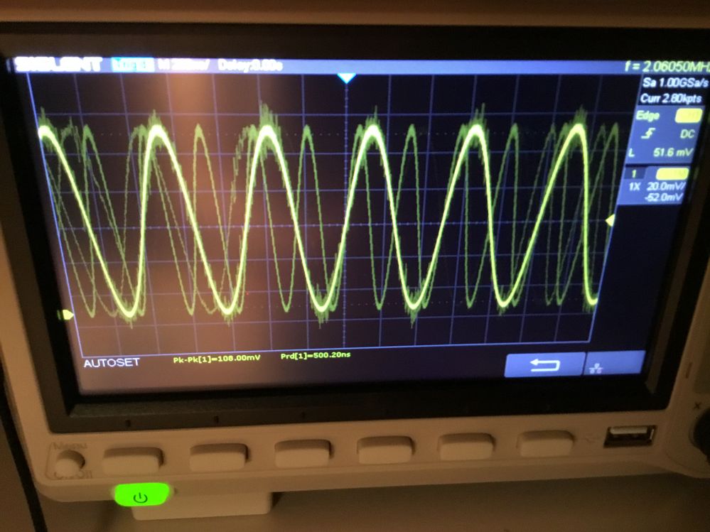

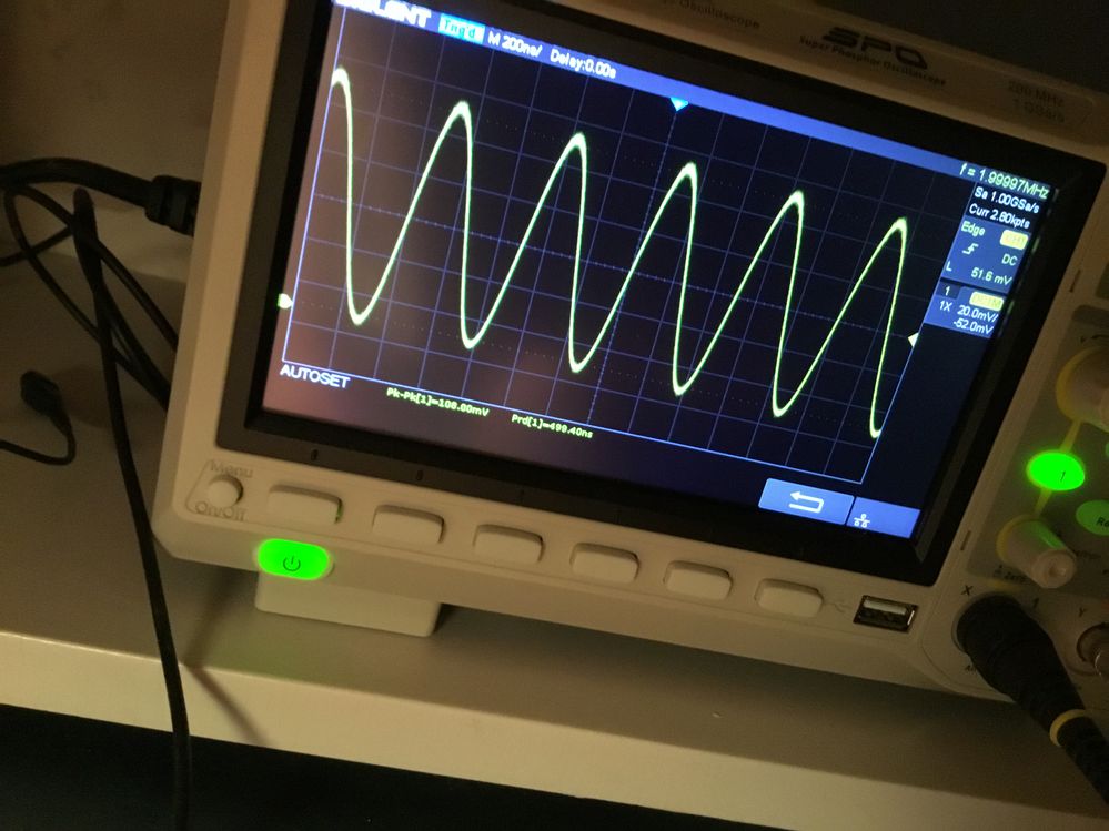

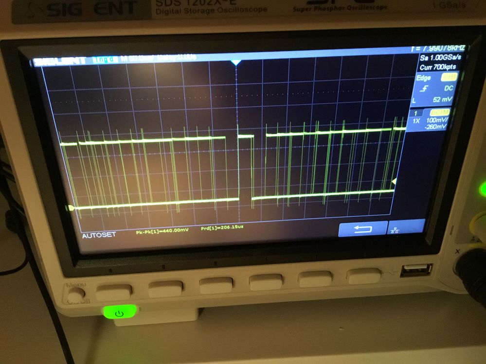

Molof
First picture is datastream from f103.
As you see its going crazy.
the next two photos is dds out...
i have programmed it to run on 4Mhz.
its weird, as you can see you have 2Mhz and some more frequensies but When i push down reset- Button on f103 its a steady 2Mhz signal... exactly the half frequency i have programmed.
so strange.
I Will try a delay as you suggestiv tomorrow.
tnx for givning me some thought and ideas to try out...

Your first scope image only shows 1 trace - should we presume that is the clock signal to the DDS? And that looks like you have the scope running continually and further more you keep re-sending the (same?) data over and over again. Is that what is happening? That could also help explain why the DDS output signal is jumping around while the CPU is running, and generates a stable waveform when you hold the CPU in reset.
You are sending 40 bits total, with the first 32 bits being the frequency data, send LSB first. Is that what the DDS is supposed to take? Which DDS chip are you using?
I am also not sure what time scale you scope is using. It looks like text at the bottom of the screen says "Prd[1] = 206.1us", so the scope thinks the period of the (clock???) signal is 206us (roughly 5KHz). That sounds very slow given the code you show, unless you are running the CPU at much less than 72 MHz. Which brings me back to one of my original questions - what is the F103's clock frequency?
Can you show 2 traces, one with clock and one with data, And only send the data one time?
