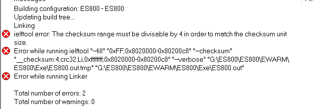

I want to use a fix part(8020000-
80200C8
) which can divided by 4 byte to do the crc, so I can avoid the odd bytes. I tried to modify the configurations in IAR. But it has errors when make. How shold I do?0690X00000609crQAA.png
Posted on February 06, 2018 at 07:23
0x8020000-0x80200C8 are 0xC9 bytes.
0x8020000-0x80200C7 are 0xC8 and hence dividable by 4
