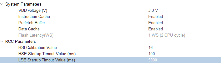

On initialisation SystemClock_Config(0 calls the function HAL_RCC_OscConfig() and this generates a timeout on the loop below:
   /* Set the new HSE configuration ---------------------------------------*/
   __HAL_RCC_HSE_CONFIG(RCC_OscInitStruct->HSEState);
   /* Check the HSE State */
   if(RCC_OscInitStruct->HSEState != RCC_HSE_OFF)
    /* Get Start Tick*/
    tickstart = HAL_GetTick();
    /* Wait till HSE is ready */
    while(__HAL_RCC_GET_FLAG(RCC_FLAG_HSERDY) == 0U)
     if((uint32_t) (HAL_GetTick() - tickstart ) > HSE_TIMEOUT_VALUE)
      return HAL_TIMEOUT; <<------
Any ideas what could be the cause of this and how to solve it?
thanks
    3 replies
    Peter BENSCH
    August 18, 2021
    Are you using a simulator or an RTOS?
    What are your settings for the HSE timeout value (see block RCC, if created using CubeMX/CubeIDE)?
    Regards
    /Peter
    EGonc.3
    EGonc.3Author
    August 18, 2021
    regarding your questions:
    I'm using FreeRTOS
    The HAL_Ticker seems to be working fine.
    I have used CubeMX to generate the configuration.
    I'm using a STM32H7A3 processor on a Nucleo board, and somehow the RCC was wrong.
    Now it's High Speed Clocmk = Crystal/Ceramic Resonator
    Low Speed Clock: Disable
    (For some reason it was enabling the Low Speed Clock!)
    Still I have a problem now:
    When is calling HAL_GetTick() on the second call below it generates an error: <signal handler called>() at 0xfffffff9
       /* Get Start Tick*/
        while (__HAL_RCC_GET_SYSCLK_SOURCE() != (RCC_ClkInitStruct->SYSCLKSource << RCC_CFGR_SWS_Pos))
         if((HAL_GetTick() - tickstart ) > CLOCKSWITCH_TIMEOUT_VALUE) <----
          return HAL_TIMEOUT;
