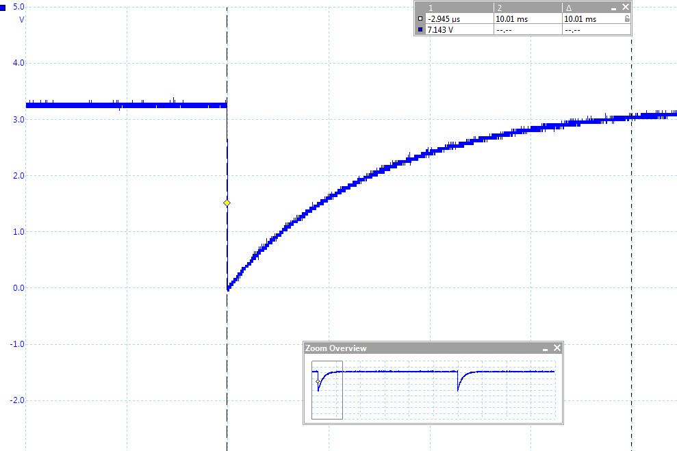

‎2019-01-22 5:14 AM
BOOT0 pin (it's the only one) is grounded the same way as it is on a development board.
And yes, reset is executed, here is the scope capture for a reset pin:
The first pulse is reset in application, which provides jump to a bootloader.
The second pulse is a reset in a bootloader before the jump to an application.
The capacitor to the ground at a reset pin is 0.1 uF, nothing drives the NRST pin externally.
It seems to me that pulse may be too short to reliably reset a controller, but I don't know what is possible to do with that.

‎2019-01-22 5:27 AM
OK, I've checked again. It seems like in cases when there no reset occurs, there are no pulses at NRST.
It means that SystemReset() is either not called or it's called but reset is not executed.
Will check this.
‎2019-01-22 9:21 AM
The NVIC_SystemReset() in itself is very simple. Most likely it isn't called. Could be some interrupt or multi-threading (if RTOS is used) related problems.
Do You set VTOR in application also? It should be done at least for debugging purposes, if debugger starts execution from application base address and therefore bootloader is not executed.
