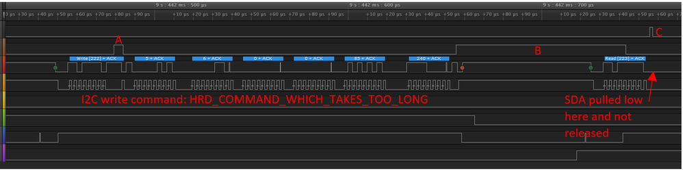

Hi, I've got a weird problem with I'd like some advice on. I've configured an STM32F334 as a I2C Slave, and am using Sequential IT driven operation with variable length packets (e.g. first byte received is length byte, followed by data packet of variable length)
Everything works exactly as planned - EXCEPT in a certain situation where the receive ISR was taking too long, and subsequently the HAL_I2C_EnableListen_IT() command was not getting called in time for the next 'read' request coming on the I2C line from the Master.
Subsequently HAL_I2C_AddrCallback() was not called, and the packet was missed...to be expected.
What was not expected was that this would cause the STM to pull the SDA line LOW, and not release it. The STM code continued to operate as if nothing had gone wrong, except now the I2C bus was blocked.
* No error states reported byHAL_I2C_GetError()
* HAL_I2C_GetState() was reporting HAL_I2C_STATE_LISTEN as expected.
* HAL_I2C_ErrorCallback() was not called
I tried sending 9+ clock pulses from the master to release the bus, but to no avail.
I've changed my code so the ISR finishes much more quickly (and everything works normally) - but I'm worried as to how this could get the I2C to lock up so horribly? Especially with no errors being reported.

This timing snapshot shows the issue:
Point A: This is a trace on HAL_I2C_AddrCallback()
Point B: This is a trace on doSomethingWhichTakes50us() which causes the next I2C transmission to be missed
Point C: This is a trace on HAL_I2C_ListenCpltCallback() which calls HAL_I2C_EnableListen_IT() fractionally too late
Does anyone have any ideas on why this is happening, and how to get out of a sticky situation like this? How can I detect that this has even happened on the STM?
