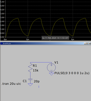

So took the scope to check the signals, beginning with reset ...all look ok, except SPI data !
Here super slow rise time...ok, no useful signal for the TFT at 48Mb. (PC3_3 is sick ?)

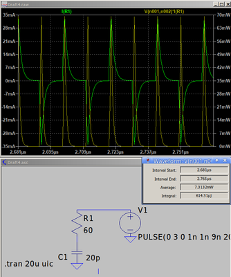

So i suspect this SPI write at more speed - was too much for the tiny switch.
Simu at this speed (with 60 ohms switch) shows > 20mA peaks , and about 7mW loss :
And for now its just on my audio-player, one cpu . Next week i will check at work, whether there is any of this over sensible pins used as IO output .

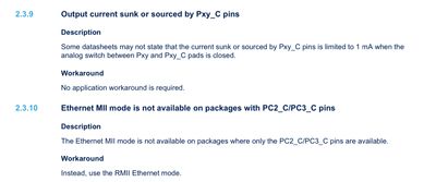

Just - it should be some warning in the ds /rm , to avoid any load > 1mA on this pins, otherwise destroy the pin output - not only small notice in errata:

We released last year a documentation  and silicon errata on _C pin usage when configured as digital and not direct analog input for ADC .
https://www.st.com/resource/en/errata_sheet/es0445-stm32h745xig-stm32h755xi-stm32h747xig-stm32h757xi-device-errata-stmicroelectronics.pdf

To get such a signal with 20pF load, i tried simple simu :
Looks similar - if "switch" has about 15k ohm now ! ?
