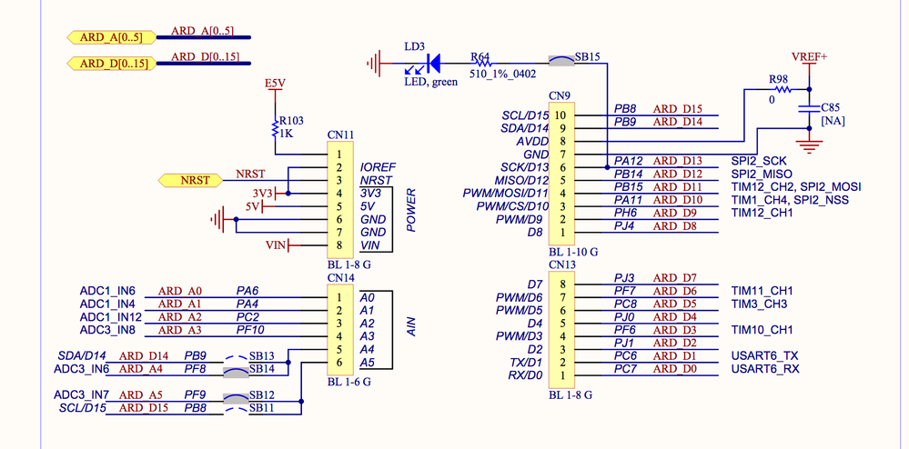

Hi , I have succesfuly managed to merge the GPIO example code into my project.
I am using the audio application project as the base project.
The GPIO button toggles the LED.
I would like to define 3 GPIO pins as digital ouputs on the arduino headers of the STM32F769I-discovery board
so far I have code below, but can't find the arduino pin : GPIO pin map ?
can arduino pins GPIO ? or should I be doing this a different way ? I just need to toggle 3 pins high and low.
UM2033 Table 13 and Fig.33

Posted on April 24, 2017 at 12:38
In Tab13, search for lines where in Comment the name starts with ARD_. Fig.33 may be more comprehensive.

Posted on April 24, 2017 at 14:59
I'd maybe forget about looking for and usingthe BSP defines, you have the info you need on the schematic
ARD_D0 is shown as PC7
To use that as an output you have to enable the GPIO clock for GPIO C and init the pin(s) as so:
GPIO_InitTypeDef GPIO_InitStructure;
__HAL_RCC_GPIOC_CLK_ENABLE();
GPIO_InitStructure.Pin = GPIO_PIN_6 | GPIO_PIN_7 | GPIO_PIN_8;
GPIO_InitStructure.Mode = GPIO_MODE_OUTPUT_OD; //GPIO_MODE_OUTPUT_PP; // ;GPIO_MODE_OUTPUT_OD
GPIO_InitStructure.Speed = GPIO_SPEED_FREQ_HIGH;
GPIO_InitStructure.Pull = GPIO_NOPULL; // GPIO_PULLDOWN;
HAL_GPIO_Init(GPIOC, &GPIO_InitStructure);�?�?�?�?�?�?�?�?�?�?�?�?�?�?�?�?�?�?�?�?�?�?�?�?�?�?
(I've also defined PC6 and PC8 as outputs above)
If you wanted to use the pins as part of a peripheral like I2C / SPI then you need to look at the examplesin the _msp files. These are where the GPIO is configuredvia callback from the HAL eg, within HAL_I2C_Init()

Posted on April 24, 2017 at 15:40
Maybe it would help if I knew the hardware address of say ARD_D0 ? Then I could work backwards through the libraries / code to see the relationship.
Anyone know where I can find that information ?
does GPIO_PIN_0 or hardware address 0x0001 = ARD_D0 ?
maybe i'm looking for the hardware address of ARD_D0 , ARD_D1 etc
'ARD_D0' is just an arbitrary name for a signal/connection in the schematics.
Down to the right of your image, at CN13, you see an instance of ARD_D0, and directly to the left, 'PC7'.
This PC7 is the actual GPIO pin of the MCU used to provide that 'ARD_D0' functionality.
You will find the pin name PC7 in the usual documents (as Jan suggested).
With time and experience, you gonna get use to read schematics.
Posted on April 24, 2017 at 16:27
thank for this, so I can use these as digital output if I initialise them as such ?
PC02 = GPIO_PIN_2 = ARD_A2  ( arduino anlouge pin 2 )
PC06 = GPIO_PIN_6 = ARD_D1 ( arduino digital pin 1 )
PC07 = GPIO_PIN_7 = ARD_D0 ( arduino digital pin 0 )
PC08 =  GPIO_PIN_8 = ARD_D5 ( arduino digital pin 5 )
are there any other physical GPIO pins available as digital outputs on the STM32F769I-discovery ?
what does PCx , PFx , PAx etc stand for ?
